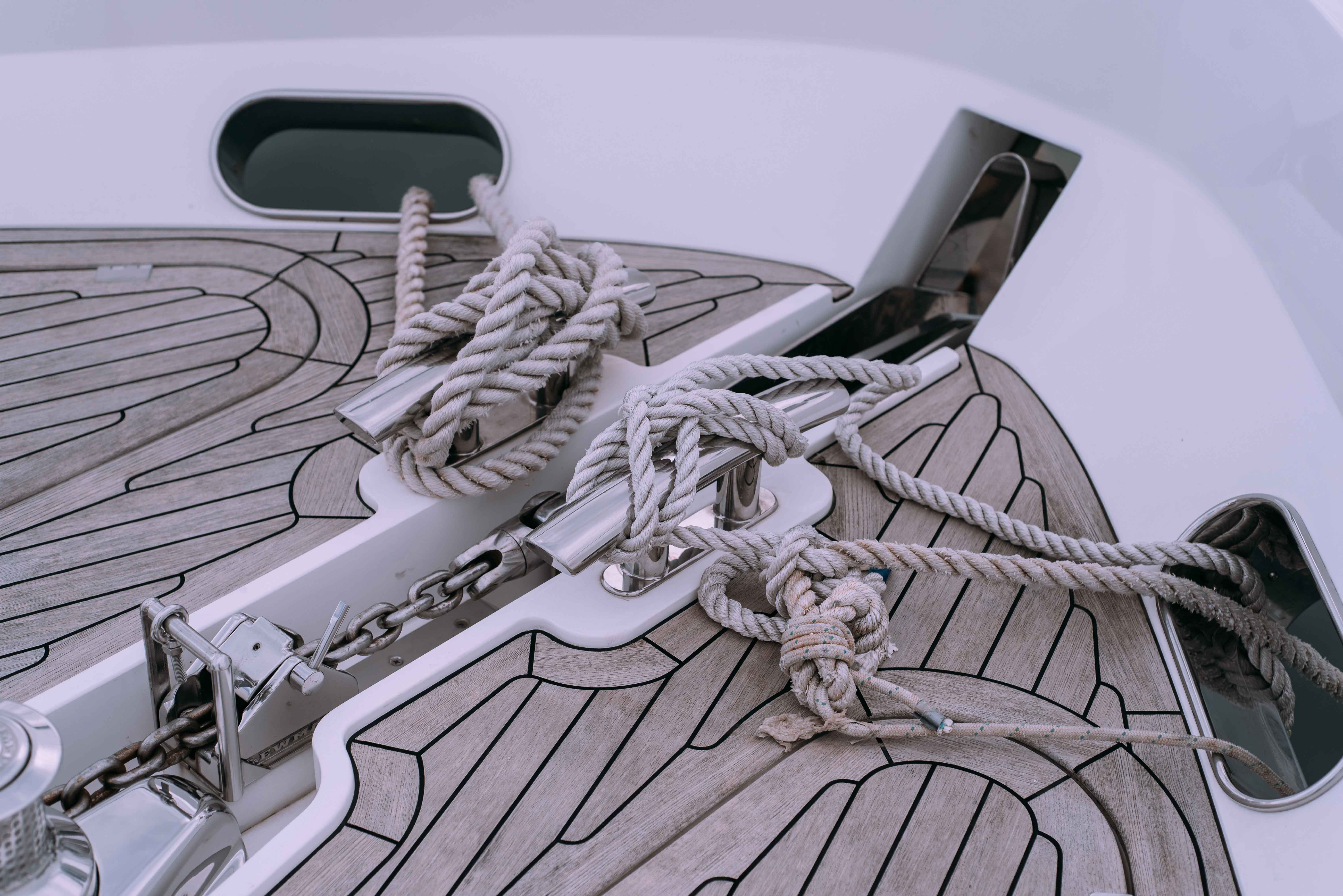

  • Prepare your anchor and rode - Make sure your anchor and rode (chain or rope) are in good condition and suitable for the size and weight of your yacht. Check that the anchor is securely attached to the rode and that the rode is long enough for the depth of the water. Make sure you have enough rode to allow for the height of the tide and that you have a snubber or chain hook to take the strain off the windlass.
