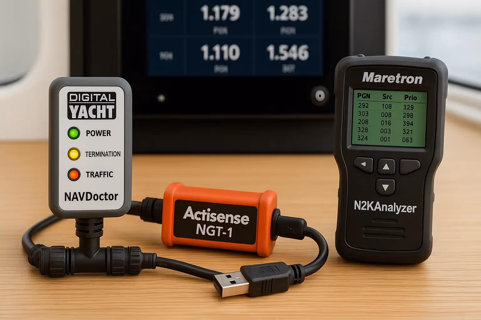

1. Digital Yacht NAV Doctor
**Best for: Quick network health checks and troubleshooting.
Features:**
  • LED indicators for power, termination, and network traffic
  • Tests resistance (termination) and voltage
  • Compact and portable – no laptop needed
  • Works with any NMEA 2000 network
How to Use:
  • Plug into any spare T-connector on the backbone.
  • Check the LEDs:Green (Power): 12V present
  • Yellow (Termination): ~60Ω resistance (good)
  • Red (Traffic): Flashes when data is transmitted
Common Findings:
  • No power (LED off): Check fuses and connections
  • No termination (Yellow LED off): Missing terminators
  • No traffic (Red LED not flashing): Network communication failure
2. Actisense NGT-1 (USB Gateway)
**Best for: PC/Mac-based monitoring, logging, and debugging.
Features:**
  • Converts NMEA 2000 data to USB for computer analysis
  • Works with CANboat, Yacht Devices NMEA Reader, and other software
  • Allows PGN filtering to isolate specific messages
  • Can simulate missing data for testing
How to Use:
  • Connect the NGT-1 to the NMEA 2000 backbone.
  • Plug into a laptop via USB.
  • Use software (e.g., CANboat) to monitor traffic.
Common Findings:
  • Missing PGNs (indicating a faulty sensor)
  • Duplicate device addresses (causing conflicts)
3. Maretron N2KAnalyzer
**Best for: Standalone network analysis without a laptop.
Features:**
  • Portable handheld device
  • Displays live NMEA 2000 traffic
  • Checks voltage, resistance, and signal quality
  • Identifies missing/corrupt PGNs
How to Use:
  • Browse active devices and check for errors.
Common Findings:
  • High error counts (bad cabling or interference)
  • Devices not transmitting expected data
